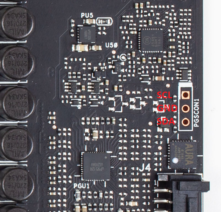

Quote from elmor on 2020-12-04, 14:59Accessible over I2C:
- uP9512 0x24 (GPU)
- uP9512 0x25 (MSVDD)
- uP9512 0x26 (Memory)
Picture credit https://www.techpowerup.com/review/asus-geforce-rtx-3080-tuf-gaming-oc/3.html
- uP9512 0x24 (GPU)
