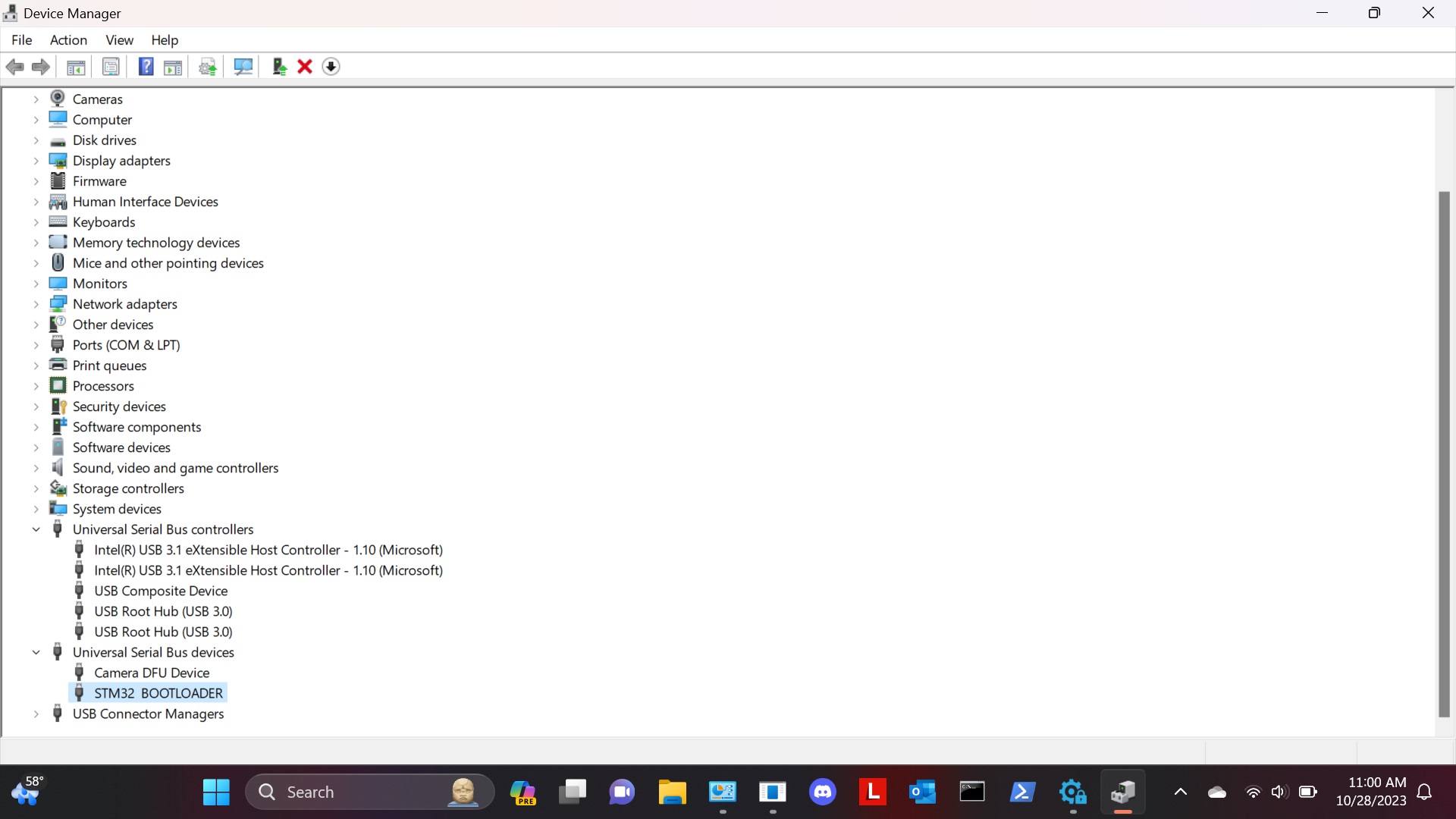

Quote from Jonathan Kurz on 2023-10-29, 00:06So Im having the same issue as the guy above. When I point the STM32 bootloader into the driver folder, it says correct driver installed.
When I unplug move the jumper the EVC show as a microelectronics device.
Any suggestion? Im just lost!
