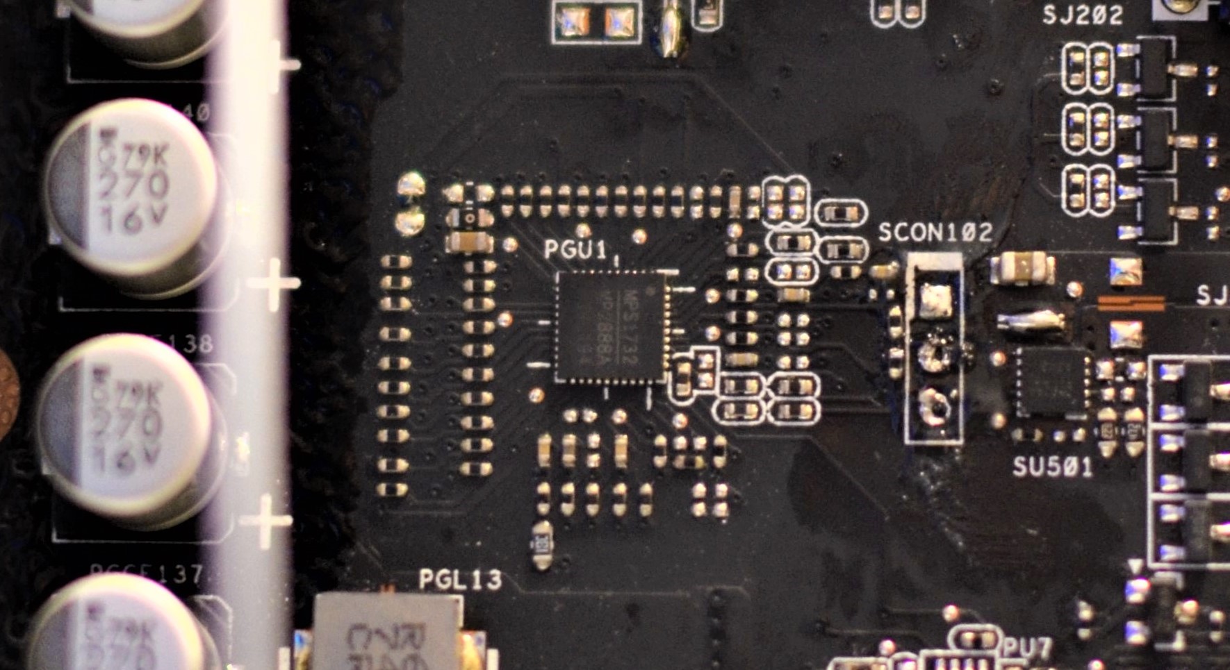

Quote from aristpan on 2021-07-09, 11:44It has mp2888a controler and a 3 pin header SCON like in the image below.

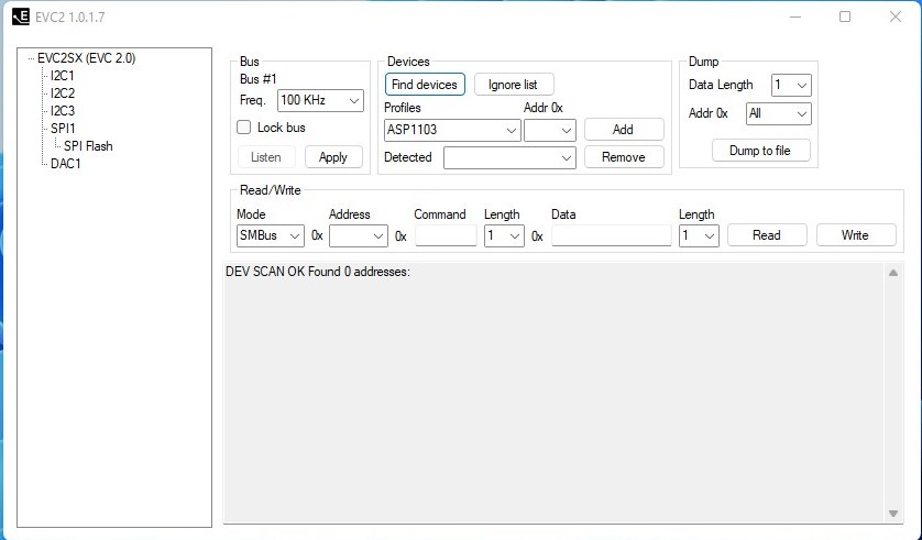

And i have already connect that 3 pin header to EVC2 but when i'm running the application i got that in the image below also

Ok that looks like the right place to connect to. Maybe SDA/SCL connections mixed up?
Quote from aristpan on 2021-07-09, 15:08Ok ground is the midle one i'll try to reverse sda and scl cables and see.
